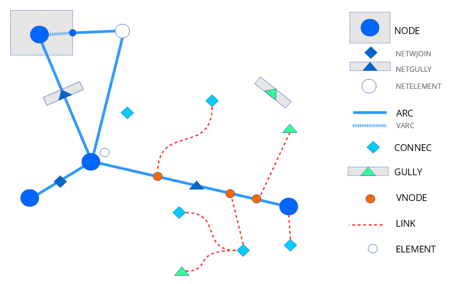

Next, we can see a basic scheme of the types of elements of the networks in Giswater.
Fig. 5.1 Schematic representation of the different elements existing in Giswater.
The main objects are:
Node
It is one of the main types of elements of the network, it is governed by topological rules and must always be the first ones to have. They represent point elements of the network like, for example, valves, hydrants, unions, meters, tanks… and are represented as points in QGIS.
The node type elements are divided into numerous categories, differentiated for ws and ud projects. Although they are always represented as points, some may have associated polygons that represent their real perimeter when it is important (for example, tanks).
The nodes always sit between two arcs and, therefore, break them into different entities (parts). Although most nodes are configured to break the arcs, there are some exceptions in which this does not happen (for example, the vents).
In addition to the nodes, in the figure we can observe:
Arc
It is another of the main types of elements of the network, it is also governed by topological rules and must always be the second ones to have. They represent linear elements of the network, that is, the conduits and are represented as lines in QGIS. All its characteristics (diameter, material, roughness…) can be added in its attribute table.
Each section must be located between two nodes obligatorily, so that they are inserted or digitalized after the nodes.
There is a type of arc called varc or virtual arc that is used to connect topologically parts of the network. This type of arc, which in reality does not exist as such, allows us to give continuity and connectivity to the network without breaking the topology of the same. The virtual arc is easy to see in the tanks where, to give continuity, we must digitalize it between the tank and the input/output of the same.
Connec
Main element of the network that represents the connections, that is, the elements that connect the network with buildings or other elements like, for example, fountains. They are represented as points in QGIS.
They are not located directly on the main network sections but are connected to it through the links.
Gully
Main element specific to the urban drainage and sanitation networks that represents the imbornals and is represented as a point in QGIS.
They are usually located at a certain distance from the main network and are connected through the links.
Link
Secondary linear elements that join the imbornals and the connections with their virtual nodes above the nearest arc, therefore, they perform the function of connecting the separated elements with the network.
Element
Point objects that are not connected to the network and that the user has the possibility to customize.
It can be about accessories of the network or any other element that is necessary for a representation with the highest degree of reality possible.

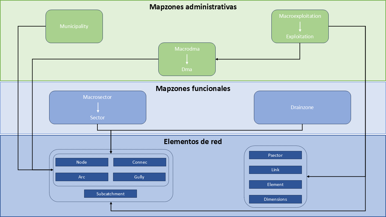

Given that Giswater allows managing water supply and urban drainage networks, each type of network has its own map zones. In the following schemas we can see the map zones for both types of network.
Fig. 5.2 Map zones for water supply networks.
Fig. 5.3 Map zones for urban drainage and sanitation networks.
