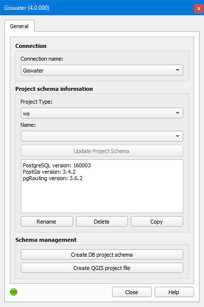

As we can see, the window is divided into three parts:
  • Connection: is the section where we must select the name of the connection with the database we want to use to work. In the case of having several, we can select the desired one in the corresponding dropdown.
  • Project schema information: this section is formed by three parts. The first, Project type, allows us to select what type of project schema we want to create. The two available options are ws for supply projects and ud for sanitation and urban drainage projects. The second part, Name, indicates the name of the schema. When it appears blank it is because there is no schema created yet. In the case of having several, we can select one or the other in the dropdown. The third and last part is the one formed by a text box in which we will see information related to the created schema. Here we can consult information about the PostgreSQL, PostGis, schema name, EPSG… We also have four buttons available:
    • Update schema: button that allows us to update the work schema when we have installed a new version of Giswater, which does not coincide with the creation of the schema. It will only be enabled when the versions do not coincide.
    • Rename: button that allows us to rename the schema that we have selected in the Name dropdown.
    • Delete: button that allows us to delete the schema that we have selected in the Name dropdown.
    • Copy: button that allows us to copy the schema that we have selected in the Name dropdown.
  • Schema management: section with two buttons which will allow us to create a new schema (Create database project schema) and create the QGIS project (Create QGIS project file).

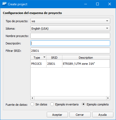

Once we know the type of project schema to create (ws or ud), we will select it in the Project type dropdown, click on the Create database project schema button and the following window will open.
../../../../_images/create-schema.png
Fig. 6.2 New schema creation window.
This window serves to specify important aspects of our work schema as well as to create it. We will have to specify:
  • Project type: type of project we are going to create (ws or ud).
  • Language: language in which the schema will be created. We can choose one of the available in the dropdown. If we are going to create one of the available examples (Example inventory or Example complete) we will have to select the English (USA) language.
  • Project name: we will indicate the name of the project schema. It cannot contain uppercase letters.
  • Description: brief description of the project.
  • Filter SRID: coordinate system of the zone where the schema will be created.
  • Data source: we can select between:
    • No data: option selected to create a blank schema. It will be the option selected when we want to work with our network.
    • Example inventory: option selected to have an example schema only with inventory data.
    • Example complete: option selected to have an example schema with complete data (inventory and EPA).
When we have specified all the data, we will click on the Accept button to start the schema creation.

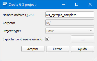

Now, the only thing that is left is to create the QGIS project for this we will click on the Create QGIS project file button.
../../../../_images/create-qgis-project.png
Fig. 6.3 QGIS project creation window.
In it we will have to specify:
  • QGIS project name: name we want to give to the project. By default it takes the same name as the schema.
  • Folder: path where the project will be saved. To be able to change the one that comes we will have to click on the button with three points and a window of the explorer will open.
  • Export user password: checkbox that allows saving or not the database access password in the GIS file.
When we click on the Accept button the project will be created and opened.
Avís
If we mark the Export user password checkbox the password will be saved in the QGIS project. If we share the project with another person we will be sharing our password as well.
Extremar the precaution with the marking of this checkbox.

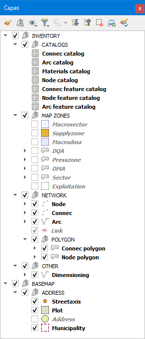

Once we have the project loaded in QGIS, we see that in the ToC a series of layers have been loaded which are grouped by thematic.
../../../../_images/toc.png
Fig. 6.4 Layers of a ws project loaded in the ToC.
  • INVENTORY group
In this group we are where we find the most important layers of the project since here we find the catalogs (CATALOGS), the map zones (MAP ZONES) and the own layers of the network (NETWORK). There is also an additional group (OTHER) that contains other relevant layers.
  • BASEMAP group
In this group we find the layers to represent the street axis (Streetaxis), the building polygon (Plot), the portal numbers (Address) and the municipal limit (Municipality).

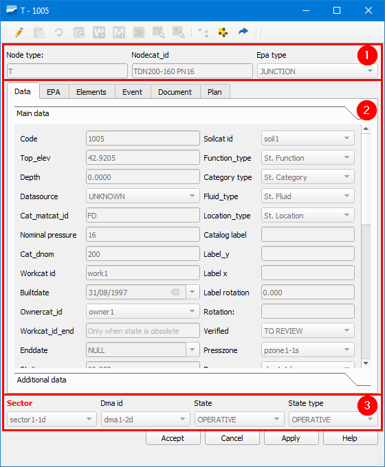

6.4.1. Forms parts
They are formed by three parts or layouts: the upper (1), the central (2) and the lower (3).
Both the upper and the lower will always be visible while the information shown in the middle will be different depending on the object we are consulting and the tab we are visualizing.
../../../../_images/form.png
Fig. 6.15 Example of form of a node of the supply network.
In the upper part we find the widgets that refer to the type of object (Node type) and its specific catalog (Nodecat_id), as well as the EPA type (Epa type).
In the middle part we find the information of each object organized by tabs.
In the lower part we find information about map zones (Sector and Dma id) as well as its state (State) and state type (State type).
Next, using the form of the previous image, we will describe the tabs contained in the middle part.
Although the form of a network object of the supply network is used as a reference, the tabs of the objects of both types of networks are explained.
  • Data: contains the data of all the attributes of the object, both the common ones of its type as well as the specific ones of the type of object. It is the most important tab. Depending on the object consulted we will see some data or others.
  • EPA: refers to the specific data of the EPA world (hydraulic simulation) and will change depending on the EPA type of the element. It consists of two columns. The INP is used to introduce the data necessary for the model and the RPT shows the results of the simulation.
  • Conections (ud): tab available only for nodes. We will see that there are two parts. The upper part will show all the arcs that are upstream of the node (Upstream features) and the lower part will show all the arcs that are downstream of the node (Downstream features).
  • Elements: contains information about the associated elements that the object may have. In the case of having associated elements a table with the corresponding data will be seen. Above the table there are several buttons that will allow us to link or unlink existing elements, add new elements or open the data in a floating form.
  • Relations: tab available only for arcs. We will see a table with the network objects that are connected to the segment (connecs or gullys).
  • Hydrometer: tab available only for connecs where we will see a table with the list of subscribers associated with the meter.
  • Hydrometer values: tab available only for connecs that serves to consult the consumptions of the subscribers where we can filter by period and code.
  • Event: as with the elements, a table with data of the events that have happened over time on our object will be shown. These events refer to all the parameters that have been registered in a visit and we will see information about the date, the type of parameter and its value as well as other data related to the visit. The available buttons allow opening the visit manager, adding a new visit, showing the image related to the event or opening its data in a floating form. In some cases, this tab is replaced by a called Visit which instead of showing the events in table format, shows them in line format having columns for each event.
  • Document: in it we will see all the documents linked to the object where the most important is the right button, since it allows opening the path and visualizing the selected document.
  • Plan: refers to the price of the object and will show a list of the costs that the element would have in the case of being renewed. This is especially interesting in the case of arcs, since they have many more variables to consider (soil type, excavation, transport to landfill…). To be able to visualize these prices, the plan_price, cat_soil, cat_pavement catalogs have to be completed and the values of soilcat_id and pavcat_id have to be assigned to the arc layer.
