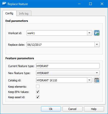

Fig. 13.1 Window of the Replace feature tool.
Then the tool window will open where we will have to specify the withdrawal file (Workcat id), replacement date (Replace date), current type of object (Current feature type), new type of object (New feature type) and new object catalog (Catalog id).
Through the checkboxes we will be able to decide whether to keep or not certain aspects of the object.
