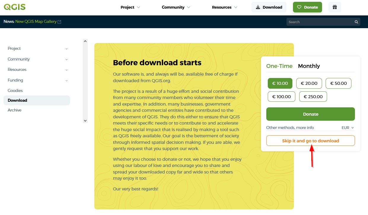

QGIS is the open source GIS program used to represent geographically the networks and interact with them. To install it, we will go to the download center of its official web where, after skipping the donation window, we can download it.
../../../../_images/download-qgis1.png
Figura 3.1 Close the donation dialog window to the QGIS project.

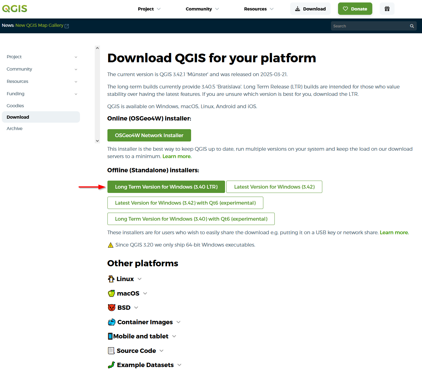

QGIS is available for Windows, macOS, Linux, Android and iOS so we will have to select one or the other depending on our operating system. Once located, we can download it.
../../../../_images/download-qgis2.png
Figura 3.2 Download QGIS for Windows.
To work with Giswater mandatorily we will download the LTR version of QGIS.

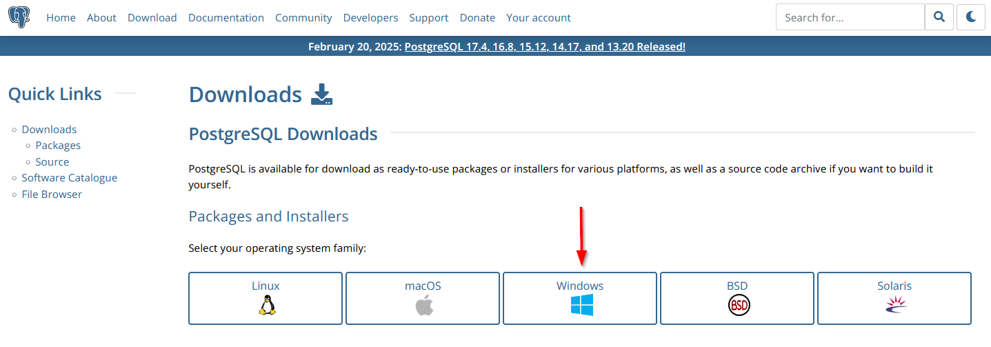

To install it, we will go to the download center of its official web where we will have to select the package corresponding to our operating system.
../../../../_images/download-postgre1.png
Figura 3.3 Download PostgreSQL for Windows.

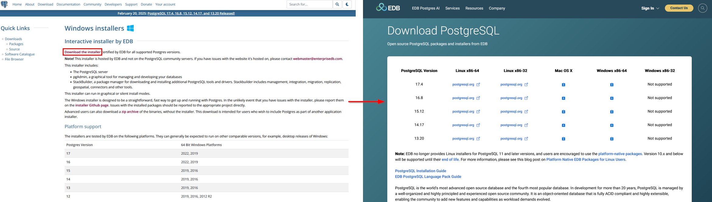

After selecting the Windows option, in the next window we will have to click on Download the installer to be redirected to the EnterpriseDB web to be able to download some of the versions of PostgreSQL compatible with Giswater.
../../../../_images/download-postgre2.png
Figura 3.4 Download PostgreSQL compatible with Giswater.

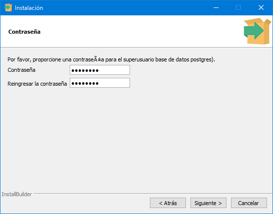

During the installation we will be asked to create a password for the superuser. It is very important to remember it as we will need to introduce it every time we connect to the database.
../../../../_images/password-install-postgre.png
Figura 3.5 Window to create password during installation.

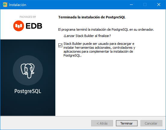

After completing the installation of PostgreSQL we will see a window that informs us of it and gives us the possibility to launch Stack Builder.
../../../../_images/finish-install-postgre.png
Figura 3.6 Window of the completion of the installation of PostgreSQL and launch of Stack Builder.

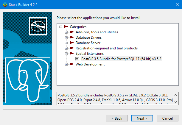

When we click on the Finish button, the Stack Builder window will open directly where we will have to select the PostgreSQL version on which we want to install PostGIS.
In the next window, we will have to expand the Spatial Extensions category and mark the corresponding box to be able to install PostGIS.
../../../../_images/install-postgis.png
Figura 3.7 Installation of PostGIS.
With the box marked, we will click on the Next button and follow the instructions to continue with the installation. Once finished, we will click on the Finish button of Stack Builder and we will already have installed PostGIS.

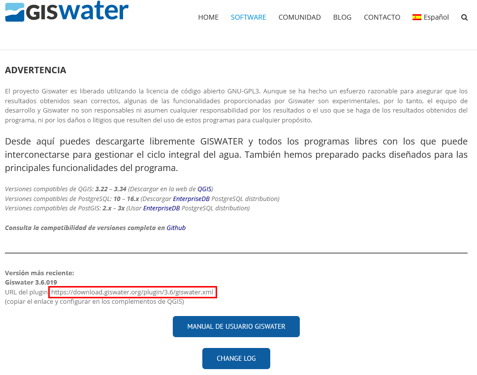

3.3. Installation of Giswater
Giswater is developed as a QGIS plugin hosted in a own repository. To be able to install it we will go to the Plugins / Manage and install plugins menu in QGIS and we will start by creating a connection to the repository where it is hosted to be able to download it. The connection URL to the repository where we can download the latest version can be found in the download center of its official web.
../../../../_images/download-giswater.png
Figura 3.8 URL of the latest version of Giswater.
If necessary, we will also have available previous versions.

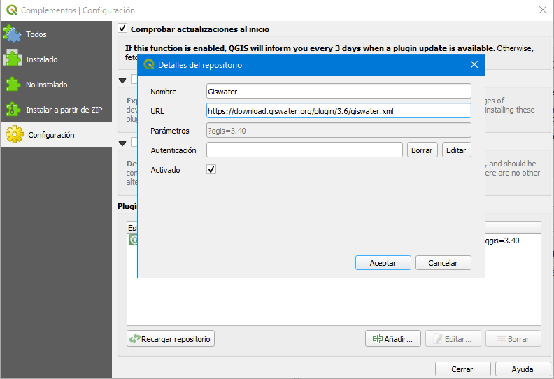

What we will have to do is copy the URL that is marked in red in the previous figure and paste it in the window to create a new repository.
../../../../_images/create-repository.png
Figura 3.9 Create new repository in QGIS.

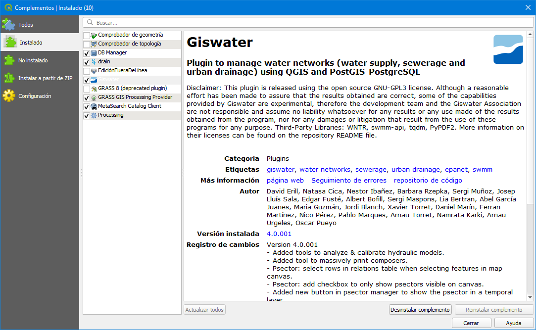

With the repository created, we will look for it in the Uninstalled plugins section and install it as any other QGIS plugin. Once the installation has finished, we will be able to see it listed together with the other installed plugins.
../../../../_images/giswater-installed.png
Figura 3.10 Giswater installed.

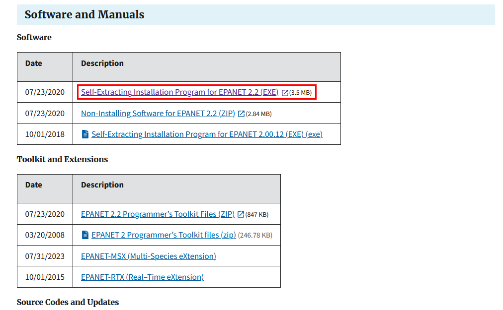

3.5. Installation of EPANET (optional)
EPANET is a program developed by the Environmental Protection Agency (EPA) of the United States which allows simulating the hydraulic and quality behavior of water in water distribution networks and is used by Giswater to perform hydraulic simulations.
To install it we will go to its official web where we will navigate through the page until we locate the file we have to download to be able to install it.
../../../../_images/download-epanet.png
Figura 3.11 File to download to install EPANET.
Once the installer has been downloaded, we will run it and follow the instructions shown on screen to be able to install it.

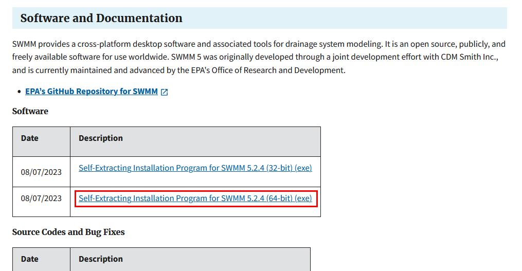

../../../../_images/download-swmm.png
Figura 3.12 File to download to install SWMM.
