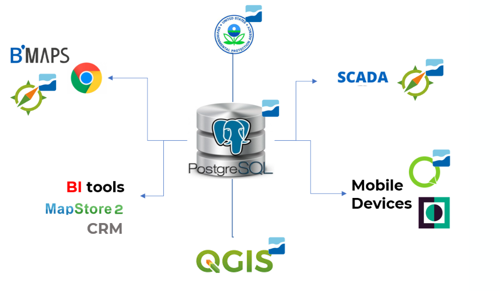

As shown in the following figure, Giswater is within a grouping of applications that, when used together, allow a global and solid management in relation to the water supply and urban drainage models.
The central element of the set is the database, where all the information and most of the functionality of each Giswater project is found. The database to use Giswater is PostgreSQL, which together with its PostGIS extension allows easily linking with the following application of the set: QGIS.
../../../../_images/intro-giswater.png
Figura 2.1 Application schema that uses Giswater, centralized in the database.
This GIS information system software is the one on which the development of the Giswater project is based, in its visual branch and with greater operability by the user. QGIS relates through PostGIS with the database, showing the spatial data organized and always taking into account all the rules, relationships and processes that the database establishes.
The central axis of the project (Database - GIS) also allows connecting with SCADA, to update in real time the information that comes directly from the physical elements of the network. In this way Giswater is presented as a global management system and that gives the possibility to its users to work always with data that are updated automatically.
