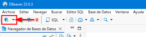

Since we recommend using DBeaver as the database manager, to work we have to start by creating the connection between it and PostgreSQL. For this, in DBeaver we will click on the corresponding button to create a new connection where we will select the PostgreSQL option.

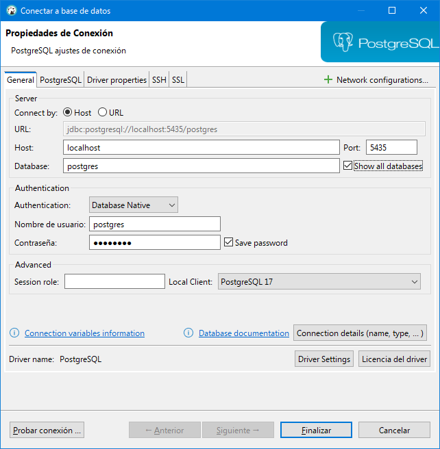

In the Connect to database window we have to fill in the following fields in the General tab to create the new connection:
  • Host: if the data is stored on our local computer, we will put localhost; if not, we will put the IP address of the server where they are hosted.
  • Port: number of the port to which we will connect.
  • Database: name of the connection.
  • User name: name of the user with which we will connect to the database.
  • Password: password of the user with which we will connect to the database.
  • Local Client: PostgreSQL client that we have installed. As we can have several PostgreSQL installed, we will have to select the one we want to work with.
../../../../_images/create-conection2.png
Figura 4.2 Fields to fill in to create the connection between DBeaver and PostgreSQL.
It is advisable to mark the Show all databases checkbox so that we can visualize all the databases that we have available. In the case of the Save password checkbox, if we are working in a corporate environment, it is recommended not to mark for security reasons.
If we only have one version of PostgreSQL installed and we have not modified it during the installation, the connection port will be 5432.

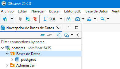

With the connection created, the next step is to create the database that will store all the information of the networks. For this, we will expand the created connection until we see the databases it contains.
../../../../_images/create-database.png
Figura 4.3 Visualization of the databases.

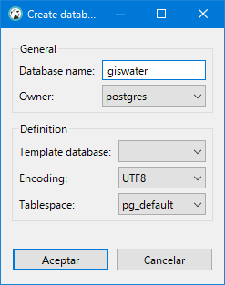

We can create a new database if we click with the right mouse button over Databases and select the Create New Database option. In the popup window we will have to specify nothing more than the name we want to give to our database.
../../../../_images/new-database.png
Figura 4.4 Creation of new database.

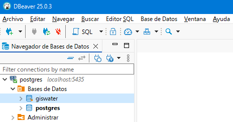

Once created, we will see it listed along with all the others.
../../../../_images/all-databases.png
Figura 4.5 Visualization of all databases.
