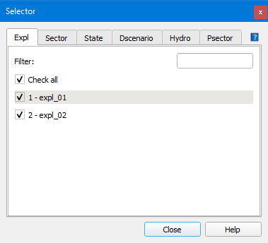

Figura 1.1 Window of the Expl tab in the Selector for a ws project.
It is divided into the following tabs:
  • Expl: shows a list of all theexplotations that we have in the project. By clicking on one of them, its display will be activated or deactivated. By activating any of them, all the others will be deactivated. To view several, the Shift key of the keyboard has to be pressed at the same time as clicking on theexplotations to be viewed.
